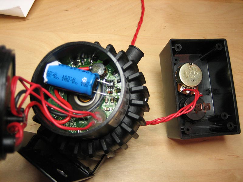

Had a chance to get it done this weekend, worked great! Ran some 22awg to a remote 10k pot and slobbered some hot glue on the newly soldered connections under the pump cover to help hold everything in place. Ran the wires out through the hole used for the original pot, too.

Awesome work there dage! Now that is the [H]ard way to control your pump speed. Who needs these fan controllers or expensive 100$++ multifunction devices to control their pumps?
Thanks, E! I'll have to follow up with the end product once I'm done... since I'm not really watercooling a CPU with this pump. The need to control flow rate will make a lot more sense soon :)
H: Massive cap was there already... didn't expect it, either, based on the systemcooling article. New rev possibly, or does DangerDen fiddle with the pumps?
Glad to see it worked for you dage! See, some of my ideas actually work :cool:
I bet you thought wtf when you saw that massive cap in there! My pumps don't have the cap either, I wonder what the thought is around it.

Yeah, it was a little bit of a surprise... thanks again for the heads up on the pot, works like a charm!
