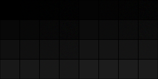

Dithering
Not only is there dithering, the dithering is not that good. I can clearly see two different types of dithering being used: spatial dithering and temporal dithering using frame rate control. The dithering is most noticeable on dark colors, like on this page: http://www.lagom.nl/lcd-test/black.php
The firmware can be updated by the user, but only in Windows. Out of the box with the original firmware, the spatial dithering looked like a fixed pattern of colored noise. After updating to the latest firmware, the spatial dithering looked like simple 2x2 ordered dithering. With both firmware revisions, the temporal dithering looked like faint noise scrolling up or down, and some shades had rolling diagonal lines.
Here is an emulation of the spatial dithering before the firmware update:
I kid you not. It really was that bad. Keep in mind that this is not an exact representation, but it's a good example of what I saw.
Here is an emulation of the spatial dithering after the firmware update:
If you don't see anything wrong, look closer. While the new dithering is much better, I could still see it. On top of that, there was still frame rate control, which added noise and rolling lines to some shades.

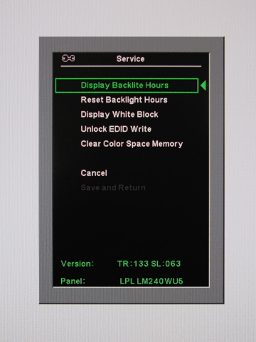

Panel
According to the service menu and the TCO'99 compliance certificate, this monitor has an LG LM240WU5 panel.
Service menu:
TCO'99 compliance certificate:

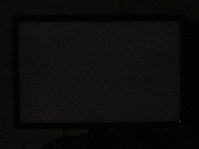

Uniformity
I took white and black luminance measurements on nine parts of the screen:
I did not see any major uniformity problems, but it's not perfect. This monitor does not have uniformity compensation like the NEC monitors do.

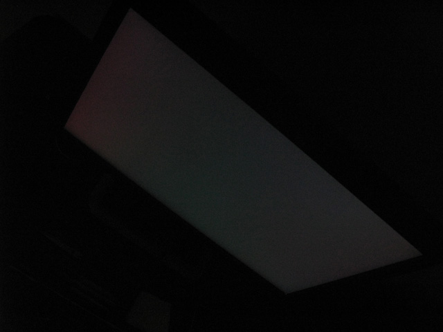

I did not see any backlight bleeding at all:
The white dot in the corner is the mouse cursor.

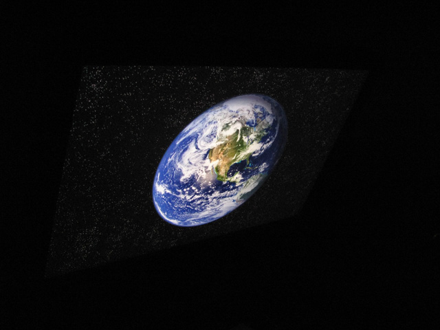

Viewing Angles

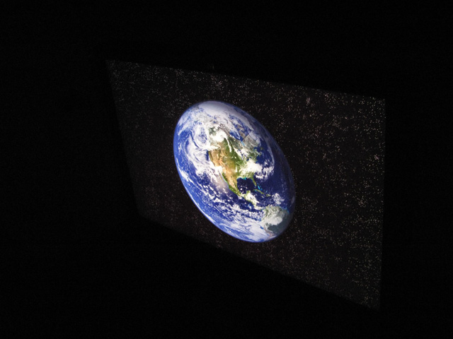

This monitor definitely has the A-TW polarizer, which prevents black from blooming at slight angles. It has the same faint red and green glow that the NEC monitors have.
The A-TW polarizer causes a red glow when looking from the right at extreme angles, which is why there's a slight red tint in that last picture. Based on my experience with the A-TW polarizer, some units will have the red tint from both sides, probably depending on the direction the polarizer was put on. There's no gamma shifting at any angle, as you can see.

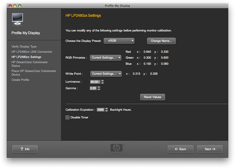

The monitor only gives you control over luminance and color temperature. The gamma can only be set with the calibration kit.
All the presets can be calibrated using the calibration kit:
It looks like the monitor can be calibrated to any gamut, but I did not see options for esoteric gamma curves like sRGB.
The software will only work with the colorimeter that comes with the calibration kit, so I couldn't test it.

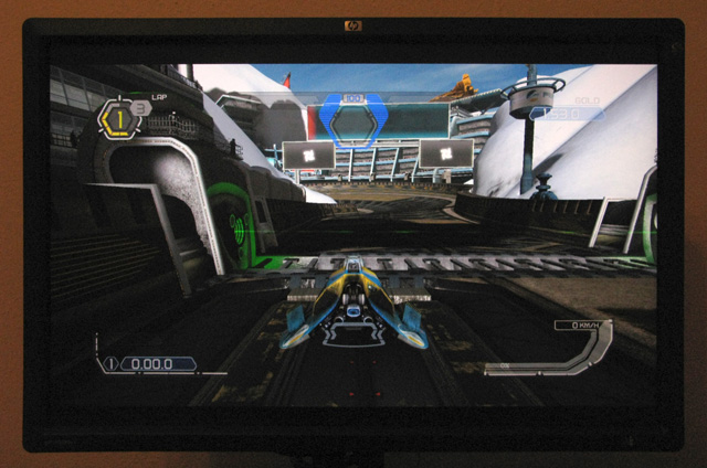

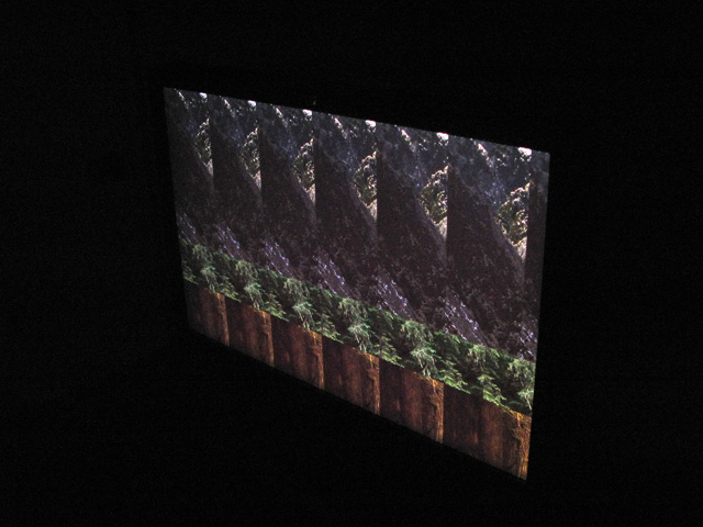

Action shot:
1080p and 720p are scaled perfectly without overscan.

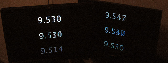

Lag
I tested this monitor against the DoubleSight DS-263N. I could not get a stable image on the HP over DVI when connected to a DVI splitter, but the results were usable. HDMI provided a more stable image and produced the same results.
DVI (left = HP, right = DoubleSight):
HDMI (left = HP, right = DoubleSight):
Every shot showed that the HP is exactly one frame behind the DoubleSight over both DVI and HDMI, which puts the lag at a little over one frame compared to a CRT (20-25 ms). Overdrive made no difference. This is consistent with what people have been getting on the HP LP2475w, so they both probably have the same amount of lag. It's not as bad as the NEC monitors, but I could still feel it. I doubt most people would notice it if there are no other lags present, but I wouldn't recommend this monitor for anything latency sensitive.

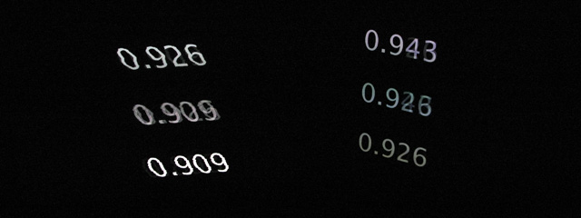

Response Time
The response reminds me of S-PVA panels. There is much less motion blur than I've seen on other IPS panels, but there's this effect, like I'm always seeing at least two frames on the screen at once. Overdrive didn't make a significant difference on that effect. I've only seen that in S-PVA panels until now.
Overdrive can be turned on and off, but with it enabled, I kept encountering subtle artifacts in static images.

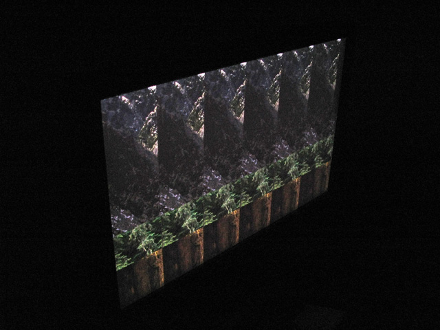

For example, this image causes a faint flickering dot to appear in one of the four copies, depending on where it is on the screen:
This is the first time I've encountered a monitor where overdrive produces artifacts on static images.

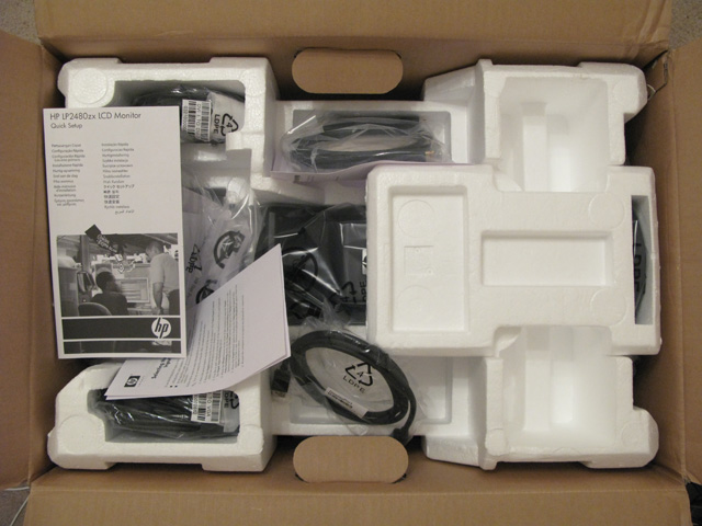

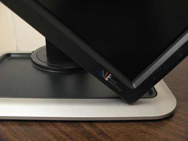

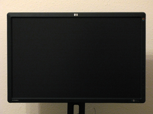

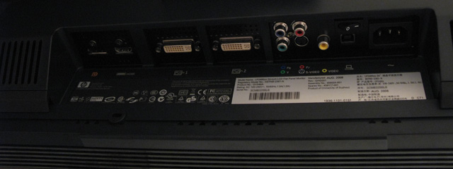

Unpacking and monitor pictures
There's not enough room to rotate the monitor without tilting it back first. Why was it designed like that?

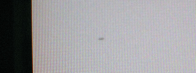

I didn't see any dead or stuck pixels, but I did spot a mark embedded in the panel:
Conclusion
I returned it for the mark embedded in the panel, and I decided not to get a replacement due to the dithering. If it weren't for the dithering, I'd say it's one of the best monitors out there, but I don't know what to think of it now.

The new firmware he mentions is the version I tested when I updated the firmware, which was released in October. There isn't anything newer as of this post.
Also, contrary to the manual and what he posted, the DreamColor Engine is enabled for 1080i over DVI but with a simpler deinterlacing method that bobs. Only 1080i (and probably 480i) over HDMI has it disabled.
Ah, he said "The latest (as of today, 12/02/08) ", which is not the same as new firmware available today. Sorry, my mistake I will edit my post.

The LP2480zx does support DisplayPort, HDMI 1.3 and dual link DVI interfaces all of which handle 10bit.
There is more to it than a connector. You need a card that will work in 30 bit mode, you need software that will work in 30 bit mode...
True, but it's nice to know that when those are all in place it'll work. Are any cards 10bit capable at the moment (Quado FX for instance).
Well considering the driver release notes, as of October this year it sounds like nVidia's DisplayPort cards (Quadro CX, Quadro FX 4800, and Quadro FX 5800) support 10bpc over DisplayPort in applications that support it.
nVidia's Quadro SDI cards have supported 8bit, 10bit, and 12bit over SDI for ages.
