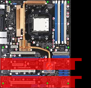

So, what can we do with this? Well, first we start with a motherboard image. The new Asus Crosshair motherboard is 30.5cm x 24.5cm. So, we find an image of that. (I've painted the mounting holes bright green. You'll see why later).
Now, this image is 244x300 pixels. So, with a little math we can figure out a scale where this motherboard image is concerned:
1cm = 9.959 pixels.
So, we can then mock up a "mask" for the 8800GTX cards by just taking 28cm and multiplying it by 9.959. Rounding, the 8800GTX should be about 279 pixels long. With the 4cm cooler bulging it out to about 40 pixels.
Like so:

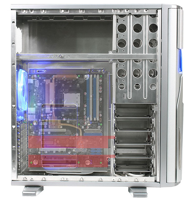

So, what's left? Well, we look for a straight-on side shot of the case in question. For this example, I was curious about the Antec "Nine Hundred" case. So, I found 90-degree level shot of its side on Newegg. Then, all I had to do in Photoshop was enlarge the image of the case until the (hilighted green) mounting holes on the motherboard above matched up.
The result is this:
Now, I wouldn't take this to the bank because calculations may not be precise, or specs may turn out to be different on launch day. But it looks to me like it'll fit (as long as that black, optional fan bracket is removed).

Here's the Antec P180.
Factors: The image of the case may not be a 100% dead-on side shot. So things might be skewed a bit.
Conclusion: It will fit, but only if you remove that middle drive bay. This might be acceptable however since the primary hard drive bay is actually at the bottom and the middle one does not contain the floppy drive bay.

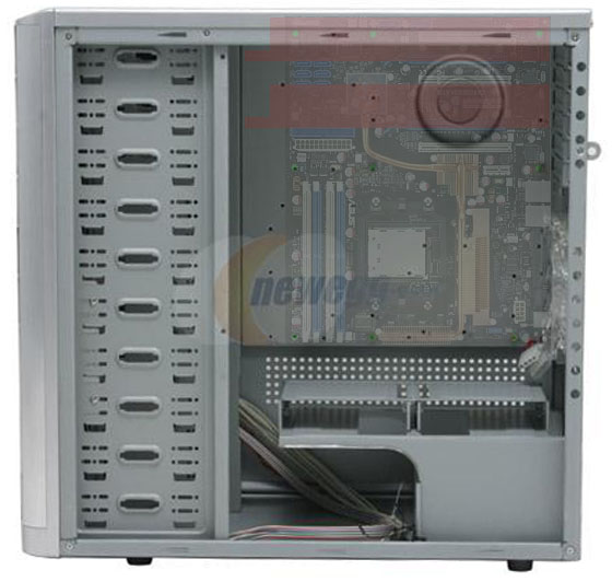

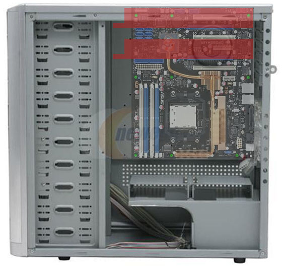

Question for the OP, where did you get the pics of the case used for comparison and would you be willing to see if the g80 would fit in an aerocool masstige
Thanx
I'm getting most of them from Newegg. That's where I got this one (not perfect, but I think it's good enough).
As always, I could be wrong here. Use this as a basis from which to further your research on whether these will fit.
Here you go:
I'm not used to "reversed" cases like that, so it's a bit tougher for me to judge. But I'd definitely say that you have "length" clearance. I couldn't actually see the top mounting holes for the motherboard (but I assume they're there), but all the others are aligned properly.
With a different motherboard where the PCI-E slots aren't so widely seperated, you might have less "crunch" up top. That's my only area of concern.
Hope that helps!
Edit: Here's a second version with the opacity of the overlay turned way down so you can see the matched up motherboard mounts:
