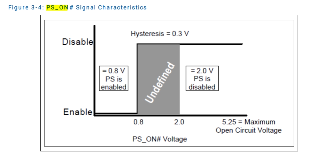

without testing yet, I believe the PSU_ON being grounded just needs to be triggered once to turn on the psu, and does not need to remain connected for the atx psu to stay powered on? I could be wrong. Do you know if it powers down if the ground is removed aka the relay turns off?
See section 3.3.3 (PDF) and the figure shortly following. tl;dr, yes, if you open the connection, the supply turns off.
