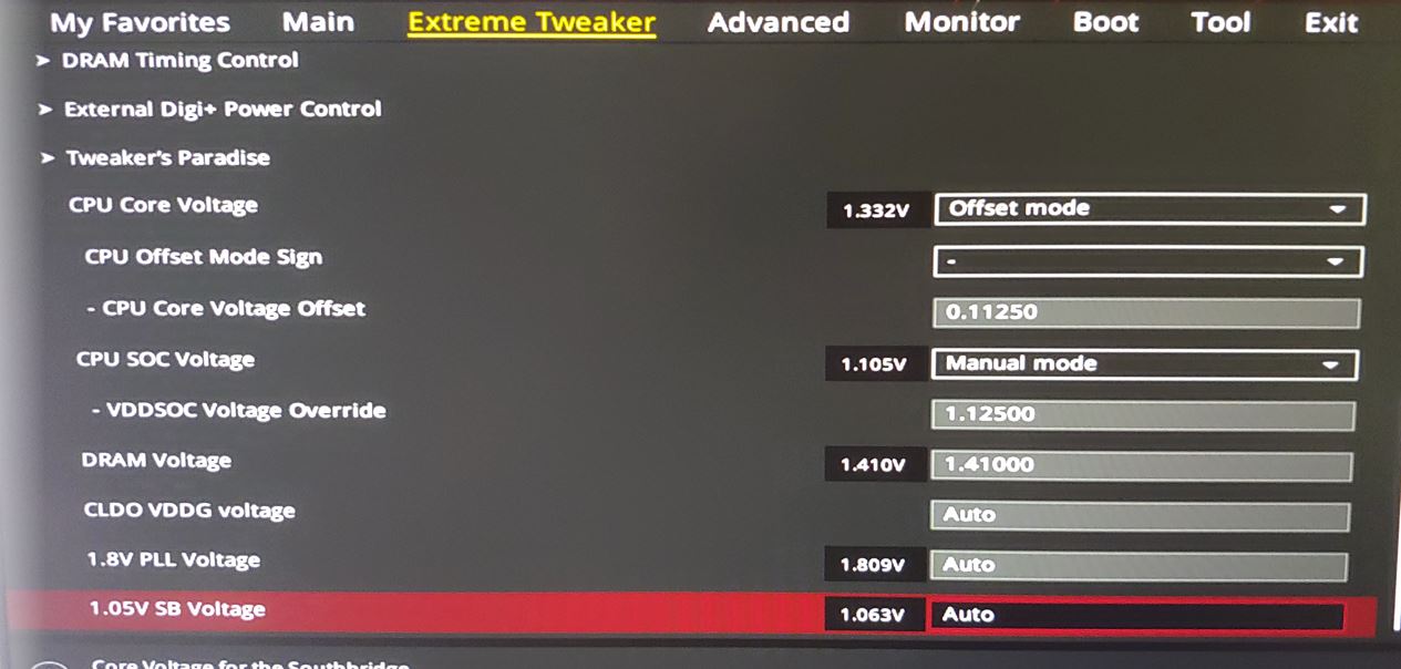

Hey, looks like you have an Asus board. Turn off FMAX in the PBO settings if it's on. Also, if you're PBO I'd kick your vcore to auto and see what happens. Also, just a personal recommendation but I'd reset to defaults and do a full power cycle between bios upgrades and especially between hardware upgrades.
Just googled the Fmax situation. Was not aware of it! I will try that later and see whats up. Also i always reset to defaults after a bios update! :)

Tried changing fmax auto to disabled. No change same temps and clocks and CB20 score.
CPU Voltage from negative offset to auto higher temps slightly less CB20 score.
Higher negative offset slightly less temp and slightly less CB20 as expected.
Back to the same settings I go! mehhh :)
