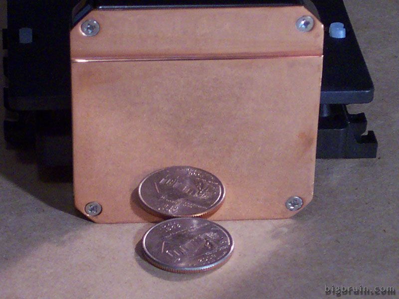

Now this is where the problem came. the CPU block is CLOGGED UP ... (see this website for more details and pics on this kit and CPU Block http://www.bigbruin.com/reviews05/evercoolwc202/index.php?file=3 its a WC202 but the only diff is the pump strength).
