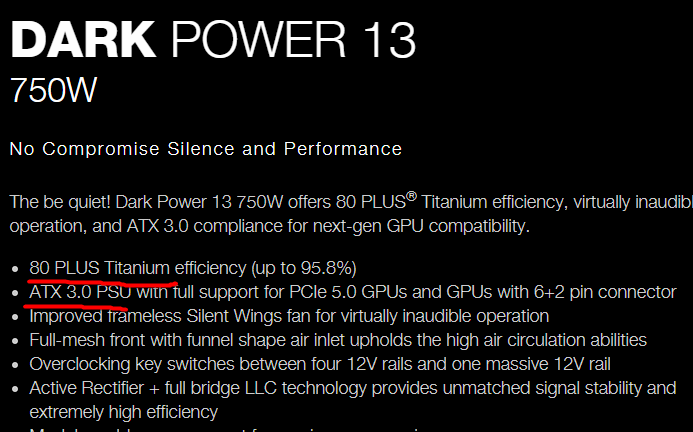

Wait a second
I chose specifically this PSU because it was Titanium + ATX 3.0 at the same time+ it has a nice discount in my country (only the 750W version).
Am I missing something?
https://www.bequiet.com/en/powersupply/4044
Altho, you may want to bump it up to 850+ if you see yourself upgrading to a more powerful GPU in the future.
